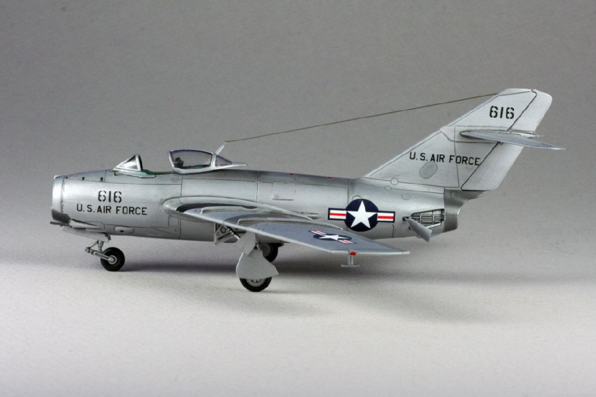

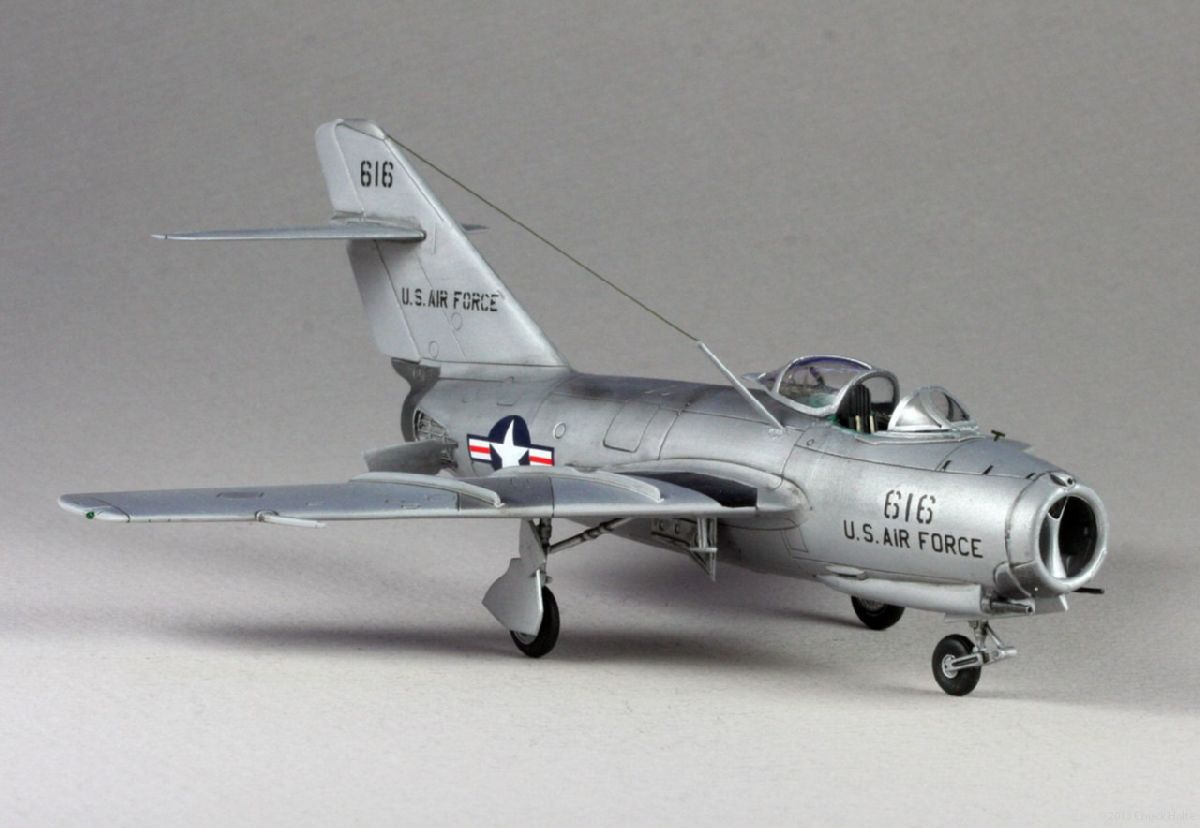

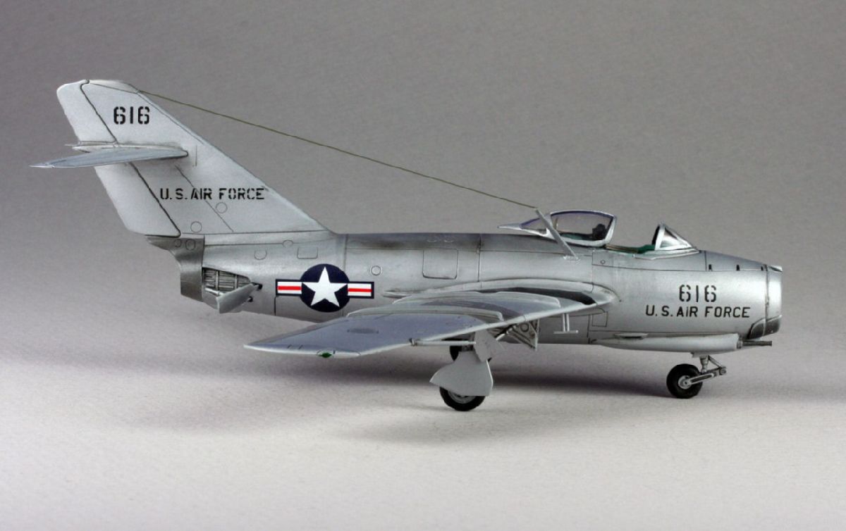

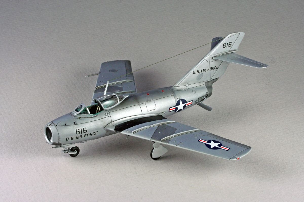

I've wanted to build a model of Lt No's MiG for some time due to its interesting history. The Hobby Boss kit is inexpensive and looked like an easy build, so I decided to model No's aircraft as it was tested in Okinawa in 1953, with US Air Force markings for "616" using decals from my spares box.

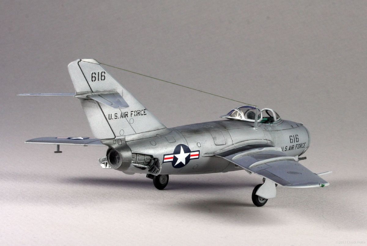

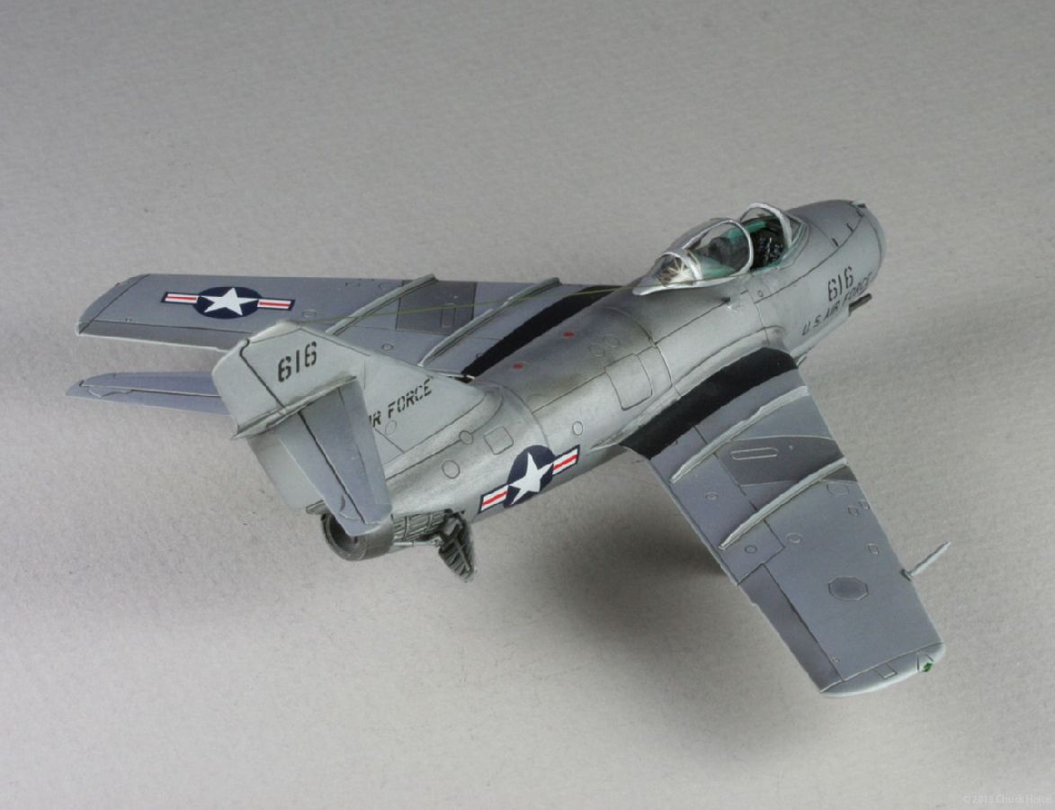

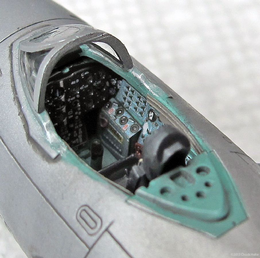

Although the instructions don't mention it, I added as much lead as I could to the front end to avoid a tail sitter. I used Model Master Interior Blue Green (Modern Russian) for the cockpit and added a set of pre-panted Eduard PE #SS336 for the missing interior details. Because the interior came out so well, I decided to separate the windscreen from the canopy with a fine toothed saw and display it with the canopy open. There were no surprises in the build, everything went together well and only a small amount of putty and sanding was needed for the horizontally joined fuselage. I used a light coat of Tamiya rattle can primer followed by several light coats of Floquil Old Silver for the completed fuselage. I experimented with several weathering methods including airbrushing a diluted mix of Tamiya Smoke and using pastel chalks to give the aircraft the well-used look it probably had when flying in Okinawa.
I enjoyed building the Hobby Boss kit and, with the addition of the Eduard interior PE set, I'm quite pleased with my model of Lt No's MiG-15. Recommended for all with an interest in first generation Soviet jets.
