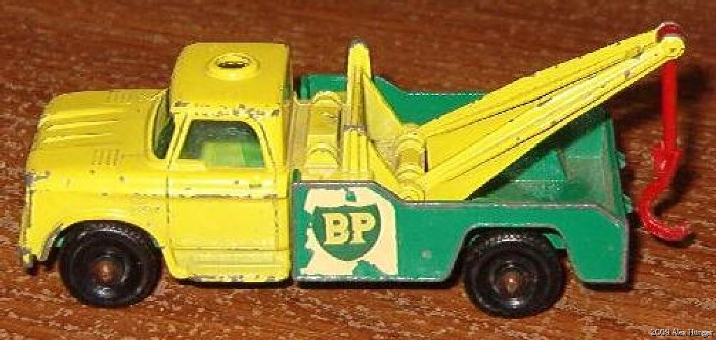

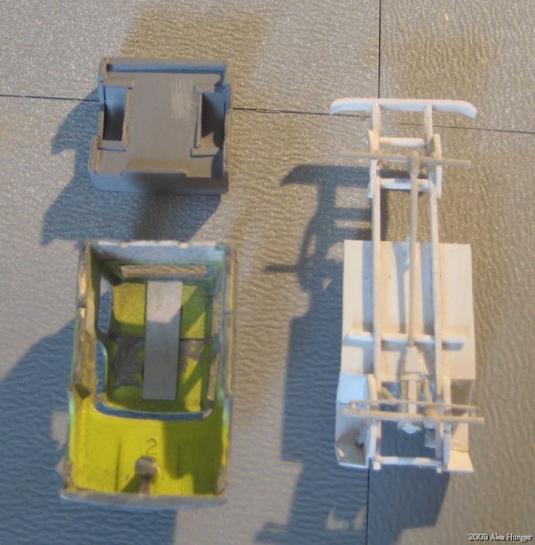

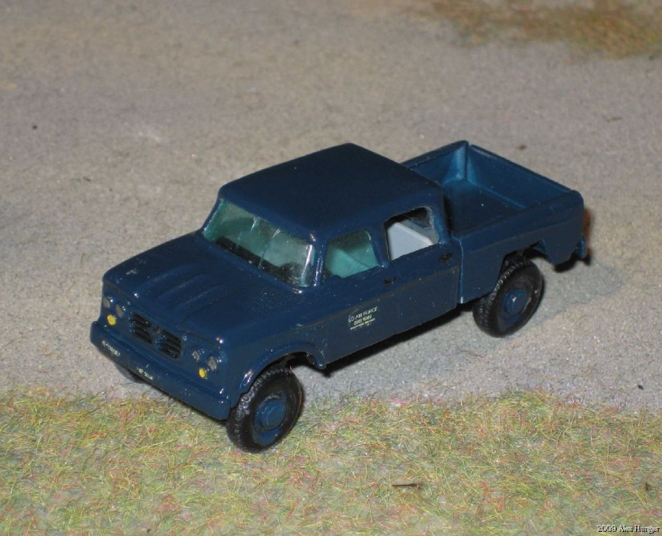

Matchbox had an interesting tow truck that bore a passing resemblance to the Swingline series but seemed taller. Google research revealed that it was a D-700 truck on a beefier chassis and with a raised cab, but otherwise it was usable. I ended up purchasing 2 of these die cast monsters on Ebay and proceeded to chop them up using my little rotary saw. I needed to cut of the rear and bottom of the cab, taking care to save the front bumper, which would be reattached. On the second vehicle, I chopped off the front and bottom of the cab. After some clean up, these were mated using superglue and a few strengthening plates on the inside. The holes for the red lights were closed up and many layers of filler later, I had an acceptable crew cab.

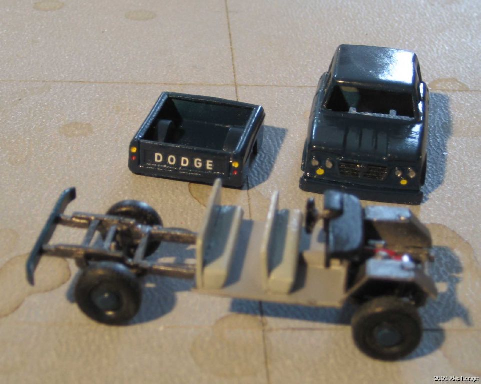

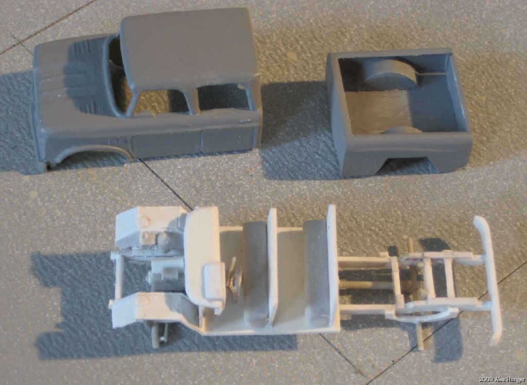

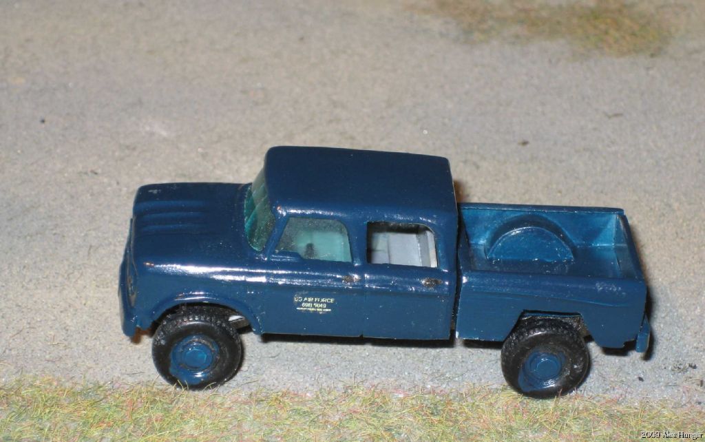

All I had to do now was to scratch build the truck bed and the chassis. Careful measurements however revealed that Matchbox had built this die cast in about 1/79 scale in order to make it fit in the standard box. This was not insurmountable, but precluded making molds for possible series production as an off scale vehicle would be quite obvious. Nevertheless, it was relatively easy to build a truck bed using left over plasticard. A little more effort was required for the chassis on which the cab and the truck bed would be mounted. Fortunately, Google revealed quite a few photos of the suspension and trans-axle as well as well as the interior and even a cut away of a simple D-100 pick-up. Two shaped beams served as the frame, while a sheet of plasticard served as the base for the seat and the instrument panels. Following this, the hand made engine, wheel arches, suspension, axles and many other details were added. Due to a lack of information, I only omitted the exhaust system and fuel tank, while I didn't want to waste a wheel for the spare tire under the rear frame at this stage of the game. Also, the rear view mirror was omitted, as I guessed that it would break off within 5 minutes anyway! This detailing only took 2 evenings and was quite rewarding from an engineering point of view.
Cab, bed and chassis were primed with Halfords grey primer, while cab and bed received a couple of coats of the aforementioned Ford Atlantic Blue. Most of the chassis was hand painted in Tamiya Gun Metal with just a touch of red for the top of the engine block and the battery. The instrument panel was done up in black, while the long bench seats were done in gloss light green to simulate the vinyl seat covers.

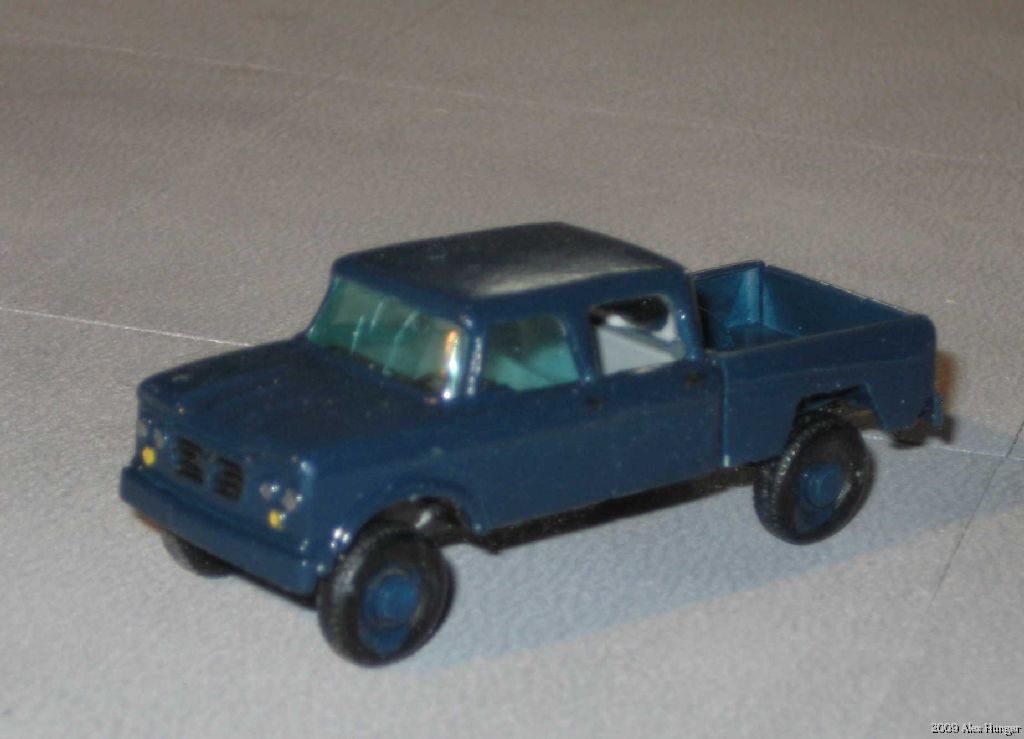

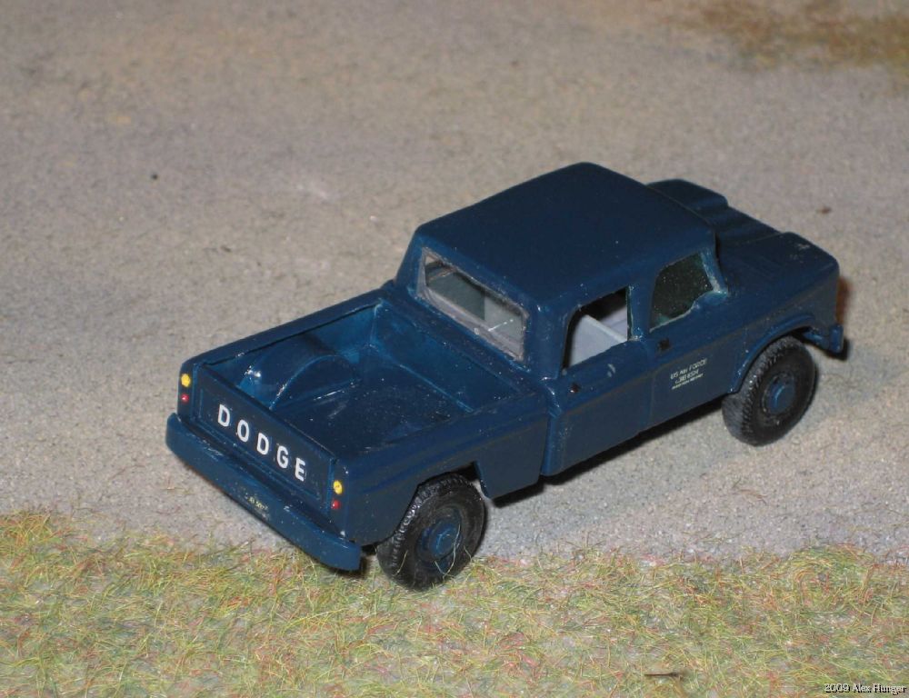

The final problem proved to be the cracked sickly green glazing from the Matchbox kits. In the end, I had no choice but to trim the best one to size and use it for the front of the cab and windshield, leaving the rear sides open. Clear plasticard served for the flat rear window, as this was an easy shape to replicate. The cab is not glued to the chassis and at a later stage I may develop the courage to vacuform my own windshield.

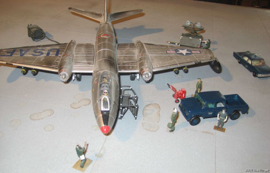

A small colour touch up brought out the lights and radiator, while the decals readied it for a photo shoot with some Hasegawa crew figures and a an Italeri B-57 on a Vietnam flight line. The oil stains on my taxiway are actually tea stains and the sedan in the rear is a Matchbox Ford Fairlane I did earlier.
