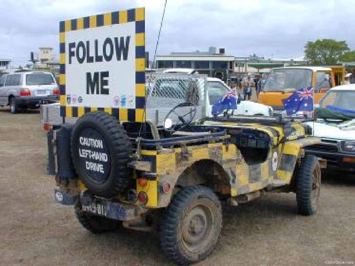

The purpose of a follow-me vehicle is to guide visiting airman and their aircraft from a post landing position on the runway/taxiway to a parking/servicing spot, often called the Transit Ramp, usually in the vicinity of Base Operations. Follow-me vehicles are conspicuously marked, often with a checkered flag, and displaying a sign directing visiting airman to “Follow-Me.” I’ve noticed photos of several follow-me vehicles while browsing the internet over the past few years and thought the subject would make an interesting model project.

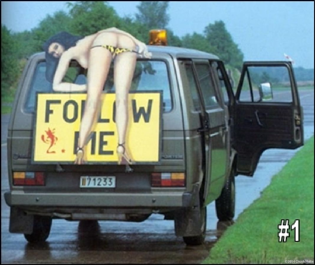

On the internet, I came upon photos of a comely lass adorning the rear of a VW bus that just beckoned me to follow. A friend had the Tamiya P-51 kit which included a 1/72 scale jeep that seemed a likely candidate for the model I had in mind.

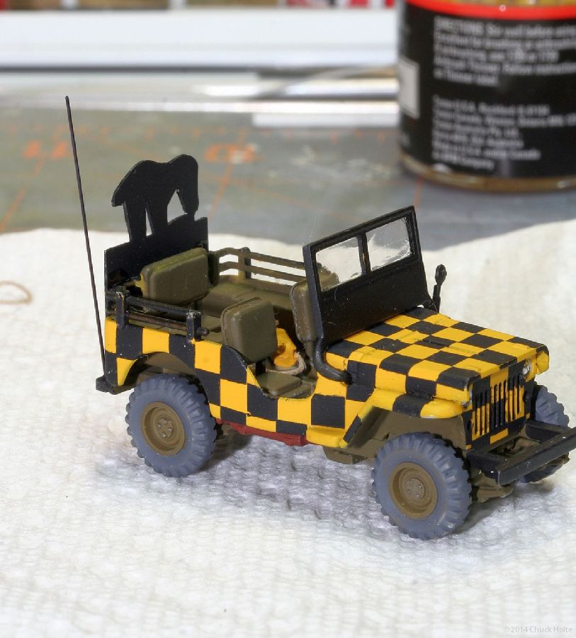

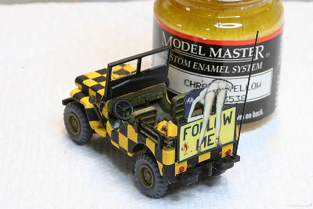

The jeep portion of the Tamiya kit consists of around 30 well-detailed and flash free parts, including full undercarriage and interior. I assembled the kit per instructions and painted the interior and underside olive drab. When the paint dried, I masked the interior and wheel wells with tape and gave the upper body several coats of Model Master Chrome Yellow gloss enamel. While the paint dried, I cut individual 1/8 inch squares from Microscale black decal sheet and placed them in the checkerboard pattern per the photo. I actually used about 50 squares for the entire project and spent several hours getting the alignment and spacing to look convincing. Once satisfied with the position of all the squares, I liberally applied Solvaset to make everything conform to the jeeps contours. I painted the bumpers and windshield frame black and the tires dark gray.
I applied an extra girlie decal to a small square of 10 thou plastic to serve as a template for the final follow me sign. Once dry, I carefully removed excess plastic with a new #11 Exacto blade. This would be the actual sign backing for the decal. I sanded it smooth and painted the forward facing side of the sign black. When dry, I applied the final girlie decal to the back and added Solvaset. I touched up the edges of the sign/decal with black paint and attached it to the back of the jeep with a dab of superglue.
An overall top coat of Poly S Flat killed the shine and blended the decals and paint in a uniform finish. I added a small piece of acetate window glass to the windshield and a small stretched sprue whip antenna to the rear bumper. I dry-brushed the floorboards and seats with flat aluminum to add a little contrast in the interior and fashioned a pair of yellow panted basswood wheel chocks to cover the hole in the floor originally intended for the .50 cal machine gun mount.
