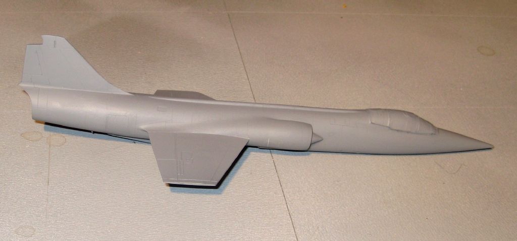

The fuselage was assembled as per instructions. The air intakes to fuselage joint required quite a bit of filling and sanding. Care also need to be taken with the front of the tail fin and where it attached to the forward fuselage as this area is a little weak. With that done, the wings could be attached, filled a bit and left to dry. I had also opened up the orrifice for the fuselage pylon.

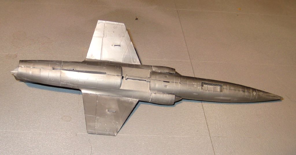

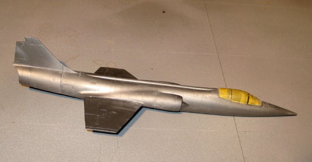

In the end, the canopy panels were masked and the fuselage was primed in Hallfords grey while the wings were primed in Hallfords white. The wings required a couple more coats and then received several light coats of Hallfords Nissan gloss white. Once those had properly dried, the wings were masked and the fun of natural metal painting could begin. The entire rear fuselage was airbrushed with the darker Allclad B steel shade. The afterburner side areas were then gently air brushed with a couple of gentle Allclad burnt metal bursts. The afterburned was also primed and brushed with Allclad burnt metal and put aside. The required sections were then masked with Tamiya tape. Contrary to popular belief, the radome is light grey and not white. This was sprayed with Tamiya USAF Light Grey and masked.
At this stage, with all the fiddly areas painted and masked, the landing gear could be installed and left to dry. This is a little tricky, as it doesn't always want to be very straight and will require a bit of gentle bending without breaking for the aircraft to sit on an even keel.
Now everything else could be sprayed with Nissan Silver and left to dry. During this time, I occupied myself with the drop tanks and pod. These all required a lot of filing and sanding. They were put asside after being primed and painted. The panel lines of the pylons were also recarved, but not attached until after the wing decals had been attached. The wheels were also cleaned up and painted. There, I recently started to use Acrylic Tamiya Nato Black, which is more grey than pure black and looks more like real tyres.
All the masking (except that of the canopy) needs a bit of time to remove but the sence of satisfaction increases with each unmasked layer. To be honest, a few touch ups on the paint job were required, but nothing serious. The matt black anti glare panel was painted on and one had something that looked like an aircraft leaving the factory. In order to help the adhesion of the decals, everything was coated in gloss. Wheels and afterburner could now be attached.

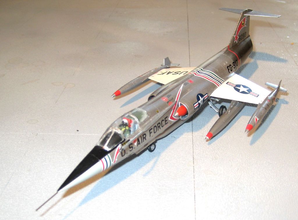

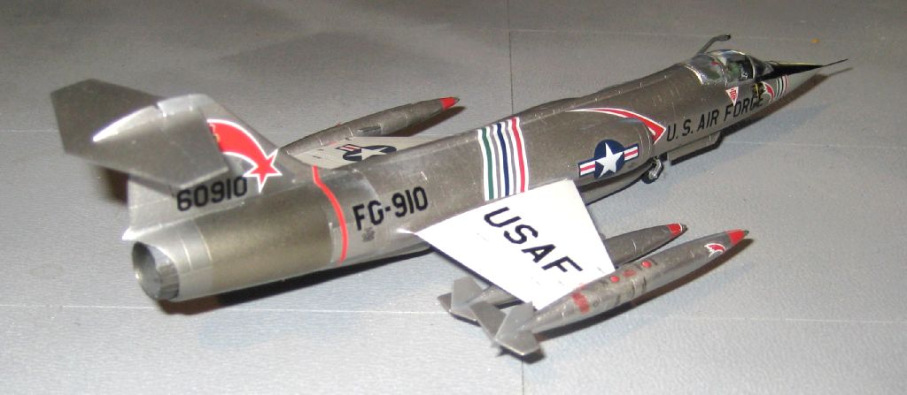

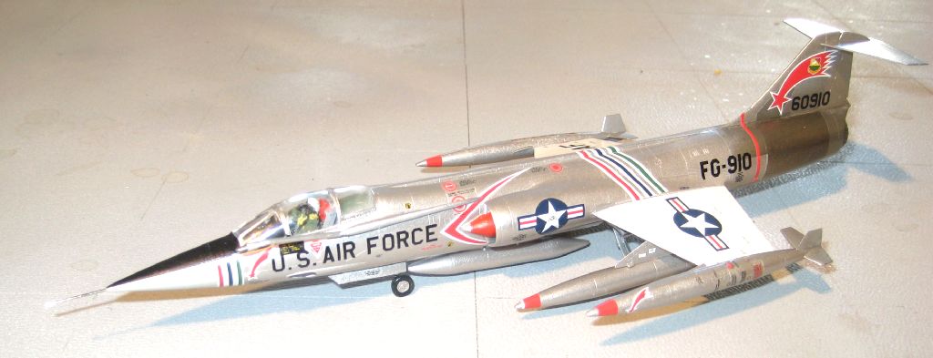

The Revell decals on the white backing sheets were bred with an instinct for self destruction. The ones with a light blue backing sheet had more of a interest in survival, even though I still coated them gloss varnish just to be on the safe side. Most of the decals for the natural metal TAC 479 TFS aircraft with colourful bits could be used as is. The decals for the wing tip drop tanks required the most convincing to stay put. The entire ensemble was again coated in gloss to seal in the decals. Last but not least, the cleaned up and pre painted refueling probe was attached and the gun barrel received a dab of Tamiya Gun Metall.
Now the drop tanks and center line pod were attached. I drilled out the hole in the radome a bit and installed a needle, which would hopefully prove more survivable than the plastic pitot tube. With the masking of the canopy removed, I had a completed Starfighter in a fetching natural metal TAC finish ready for service in over Conus.
