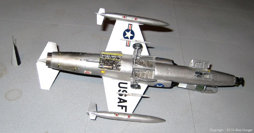

For this detailed model, I first selected the fuselage parts and cut out the electronic and engine panels that were to be open. The pre painted resin engine was slotted into the assembled the rear fuselage in a very straight forward manner and masked.
The front fuselage assembly was only marginaly more complex. This was due to the requirement of sanding some of the insides of the resin bits and then juggling cockpit components, electronic bays and landing gear bays within the half shells. Nevertheless, it all fit together more than satisfactorily. That said and done, front and rear fuselage could be joined with the wings and main landing gear.

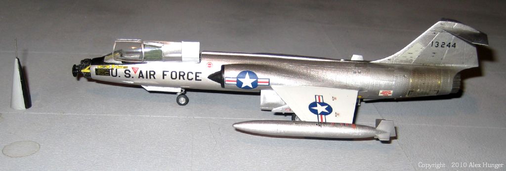

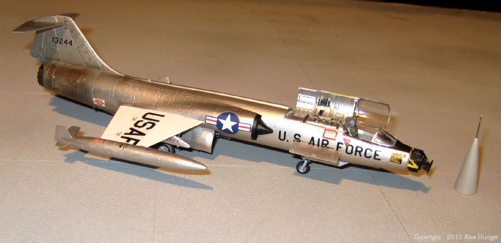

The hull was then primed in Hallfords grey, while the wings were done in Hallfords matt white. Any last blemishes were resurfaced and then the wings were sprayed in gloss white. Once dry, they were masked in order to be able to concentrate on the rest of the fuselage. The interior was done largely in grey and black and received the standard kit decals for the instrument panels. The front canopy was then also attached and masked. The burnt areas on the rear fuselge was more fun. It received several coats of different shades of Allclad II, icluding burnt afterburner etc. This was then masked so that the rest of the fuselage could be sprayed in Hallfords Nissan silver.
When all the paint had dried, the maslking was removed and the aircraft received a coat of gloss varnish. The pre painted wheels, front landing gear, landing gear doors, tailplane and pylons were all attached.
The kit only had German decals as I previously mentioned, but fortunately, the already used decal sets from the Hasegawa TF-104G and Esci F-104C kits had enough spare bits to decorate most of the aircraft. The rest could be sourced from the spared box.
That left the last of the superdetail bits and the wing tip fuel tanks to be installed, that had been omitted in order to avoid damage and ease decalling. The radar unit was superglued to the front bulkhead and painted black after some missing small plasticard struts had been added. The bulkhead and struts were touched up in Zinc Chromate. The electronic bays were also touched up with Zinc Chromate, grey and black were necessary. At this point it became clear that the cockpit was a bit too shallow or the Aeroclub seat a bit too tall. Some trimming at both ends alleviated the problem to some degree, but it wasn't perfect. Since the canopy didn't have to close, it isn't going to get my blood pressure up too much. The covers and canopy were then the last to be installed. The radome was also painted, received a needle pitot tube and was placed next to the aircraft for the final photographs.
