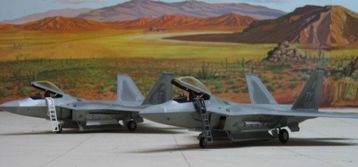

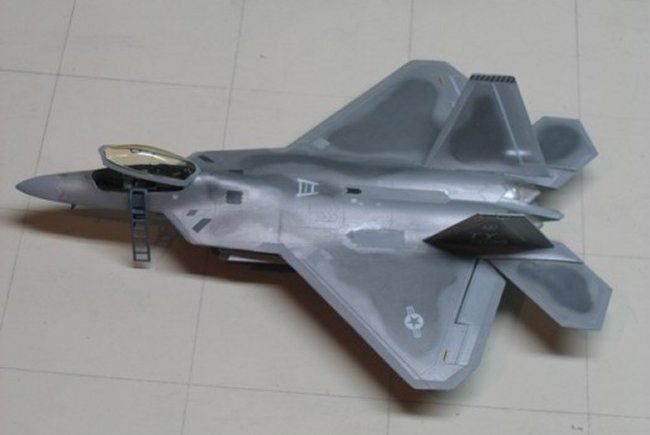

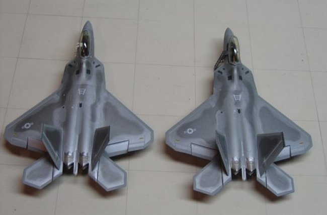

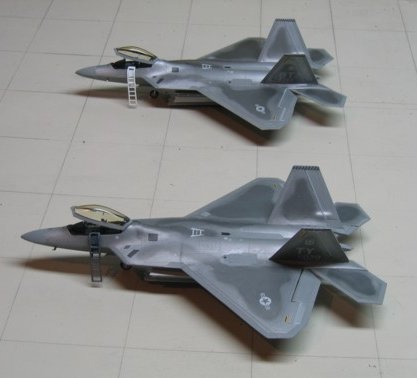

The models shown are 1/72 scale F-22A's by Italeri.  The one with the "OT" tail codes doesn't have the tinted clearcoat as the "TY" one.  Looking at the pictures note how the colors appear different based on viewing and lighting angles.
