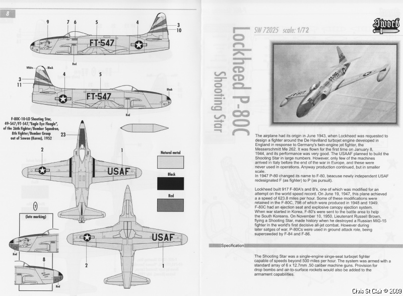

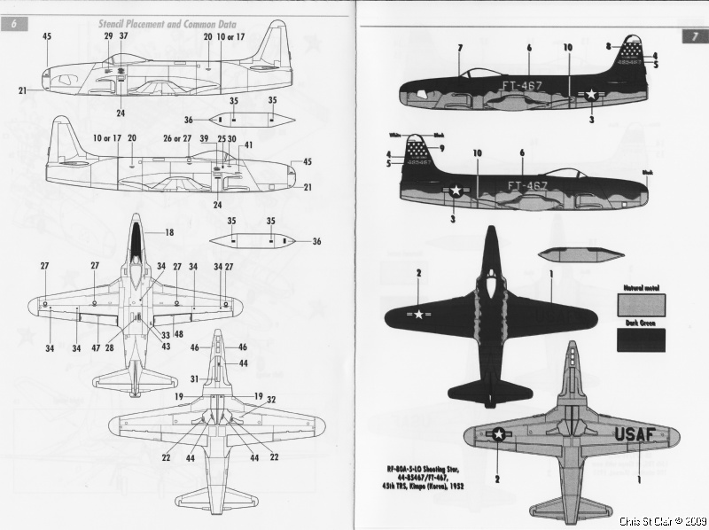

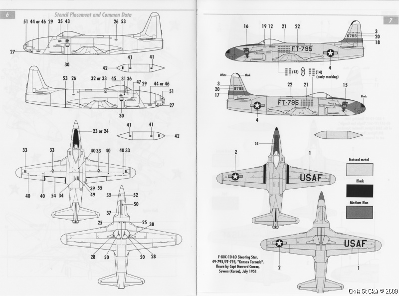

DECALS
Nicely printed by Techmod - in register, with the smallest type readable under a magnifying glass. However, no shark mouth for Eagle Eye Fleagle, and no tank stripes.

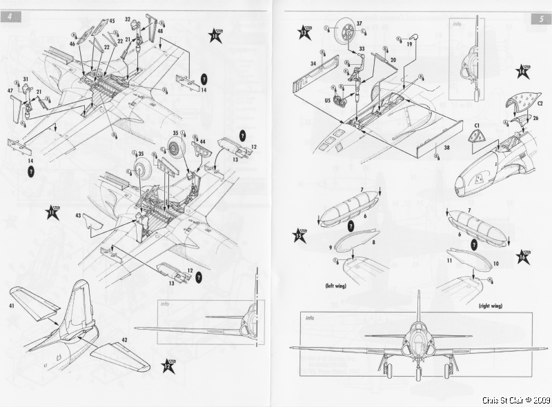

Flaps are not dropped (as in Gran kit), but it's a simple matter to cut them out and detail with some ribs.
Tip Tanks: Two types are provided: the original 165 gal faired type; and the later Misawa 265 gal. The RF's also flew with modified 165 gal tanks which you can fashion by removing two sections from the Misawa tank. If you want super accurate tanks (for instance, having seams on the original tanks), I recommend Fox Three Studio tanks - he offers no less than four type of tanks carried by F/RFs, including the T-33 style which some Shooting Stars carried in Korea.

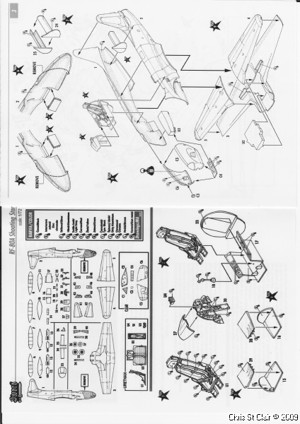

FIT
I'll post more in an in-progress build, but as a preview, this kit is a challenge to put together!!! One area in particular, the "confluence" of the intakes, wing,fuselage, and wheel wells, is particularly irksome - be prepared to do a lot of sanding, cutting, trimming, and grinding while you're doing incessant test fitting, not to mention puttying and Mr. Surfacering!!
Fit of wing bottom to fuselage needs trial fitting and more fiddling (imprecise fit, but only a small gap at the wing to fuselage joint.....
Resin wheel wells - outstanding - but once they are in place, the fit of the front fuselage is terrible, requiring a lot (I MEAN A LOT!!) of trimming of the resin!!!
