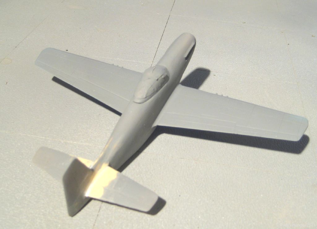

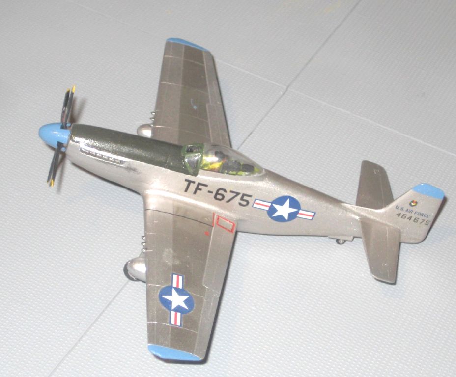

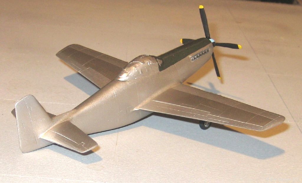

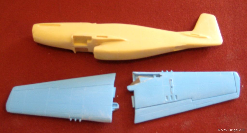

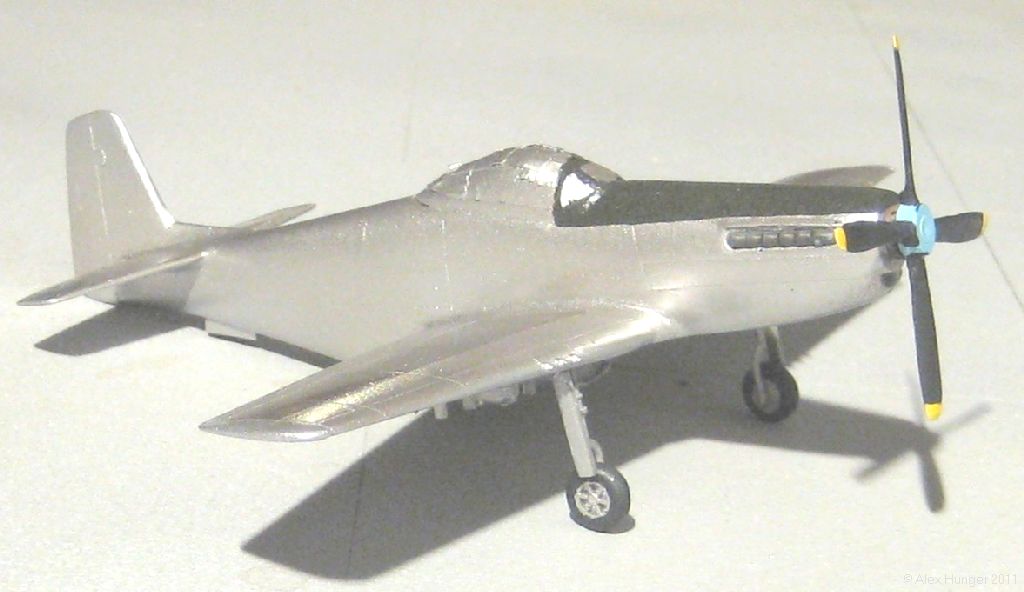

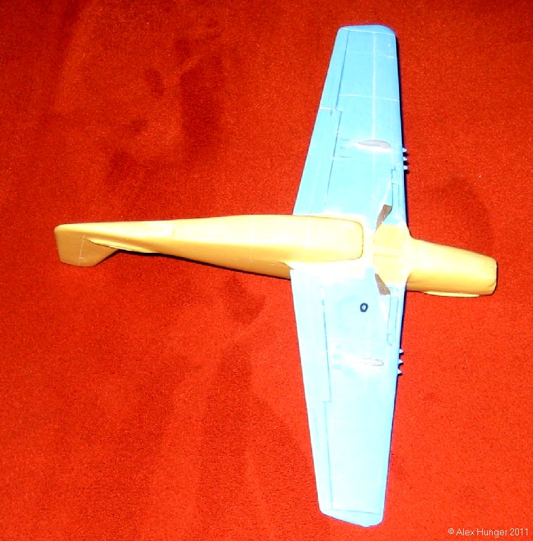

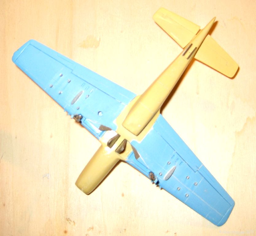

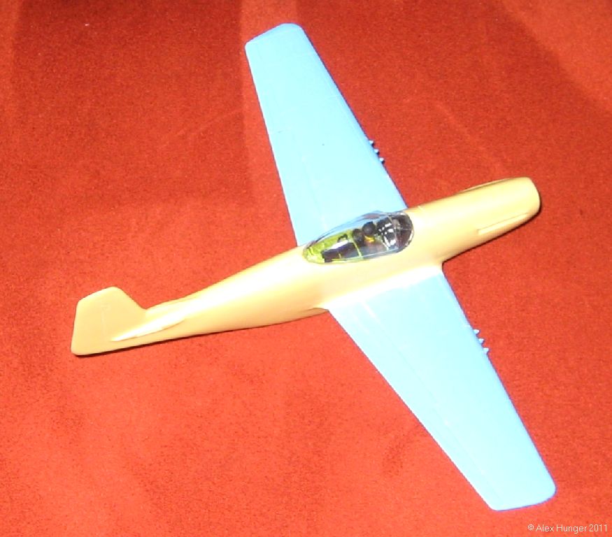

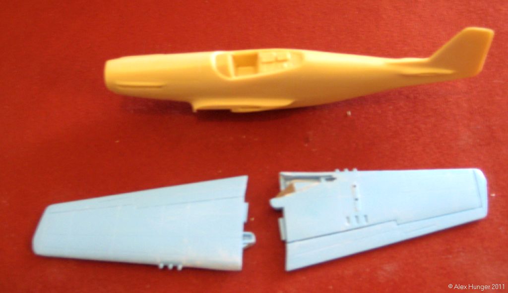

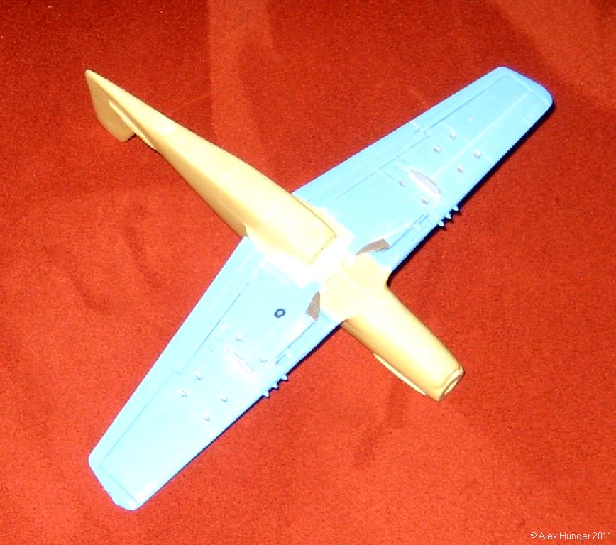

My solution turned came from the €5 parts bin at a Dutch model show. There I found the impressive Maintrack resin conversion kit for the Matchbox Mustang, which itself only cost me €3.50 on Ebay.

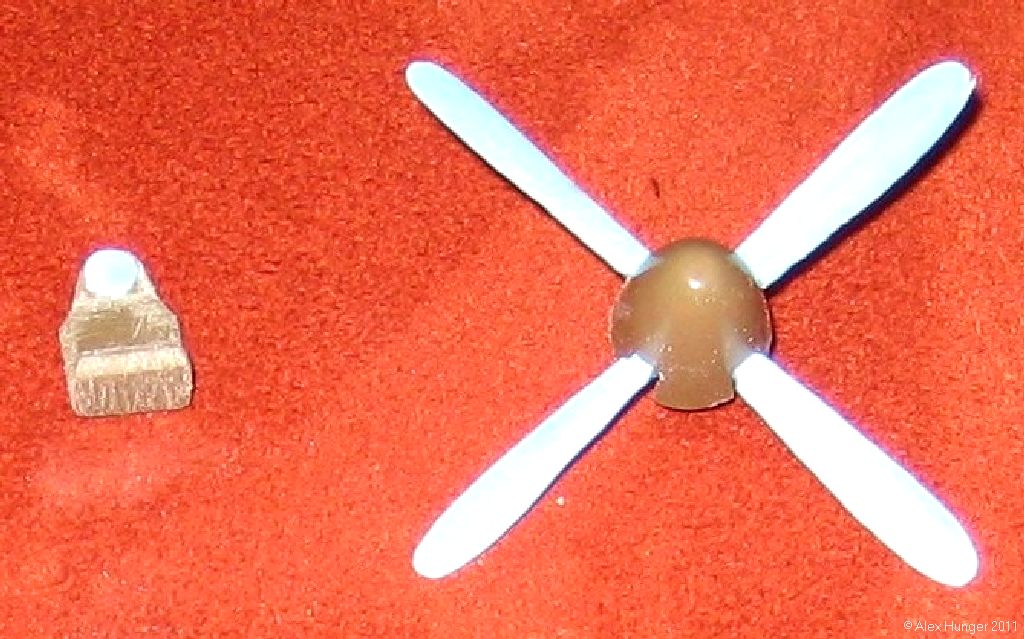

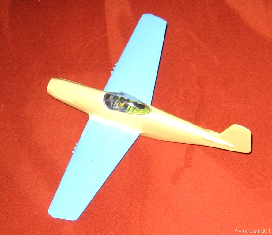

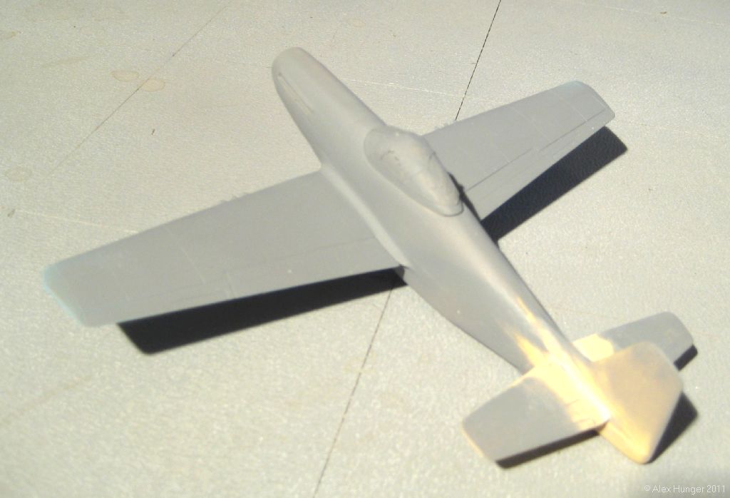

The Matchbox wings are apparently a little too thin, which makes them just perfect for this conversion. The beauty of this kit is that the resin fuselage fit Matchbox wing like a charm. I only needed to remove the “chine,” reposition the landing gear bays and recarve the panel lines. The seat needed serious trimming and the Pilot needed to have his legs chopped off in order to fit the narrow cockpit. The tail plane was a little on the rough side, but the small resin wheel were delightful. I only needed to drill out the front of the fuselage a bit to make the prop assembly fit and sand off the sleeves of the props themselves. The canopy and other standard Matchbox parts also fit very nicely.

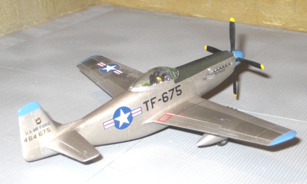

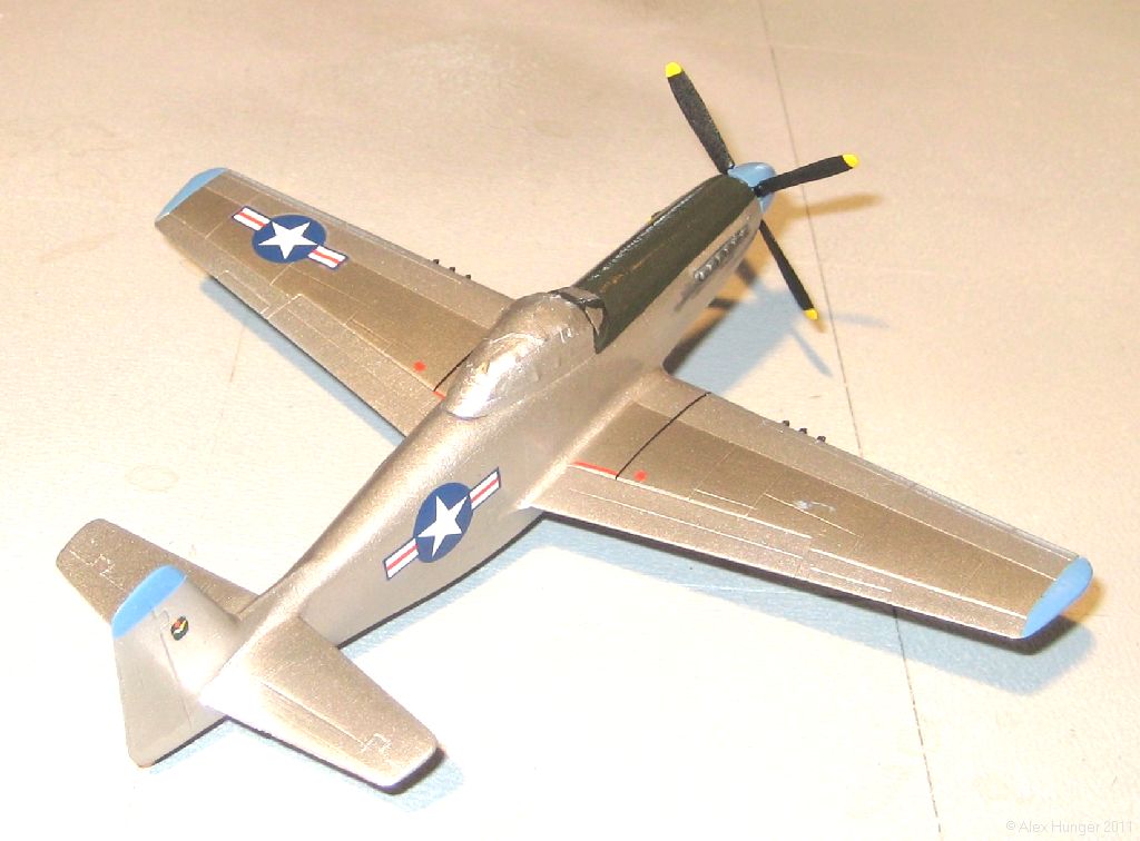

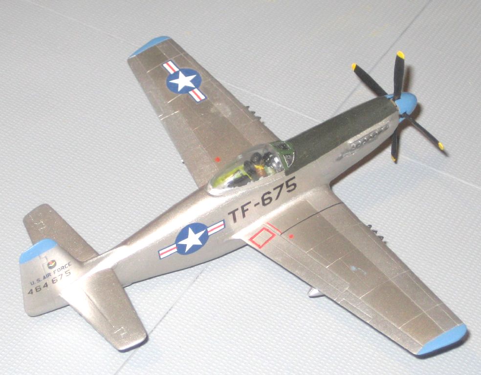

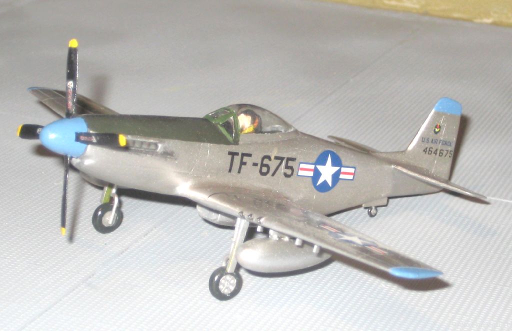

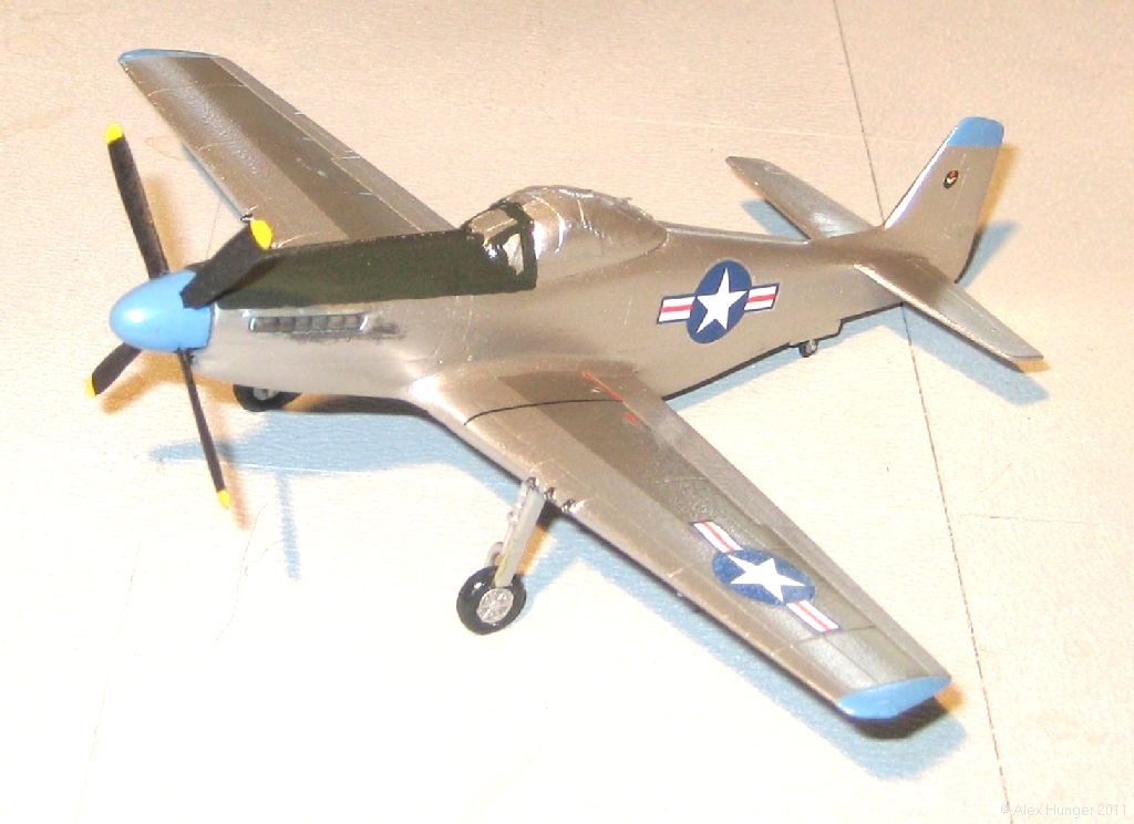

USAF Decals had to come from the spares box, while Phil ran off some serial and Buzz numbers which I had printed by Fritzche Modelbau. The Air Training Command badge from the Microscale set was trimmed to fit. The decals for the prop came from the F-82 Twin Mustang kit.
All in all, this fills an obscure but interesting niche in the USAF inventory, and at least for me at a price that compares favourably to a new Academy F-51D kit.
