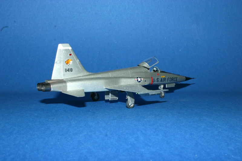

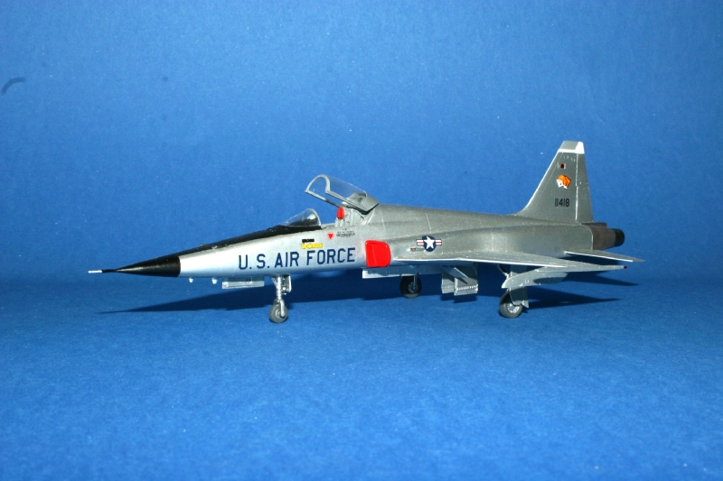

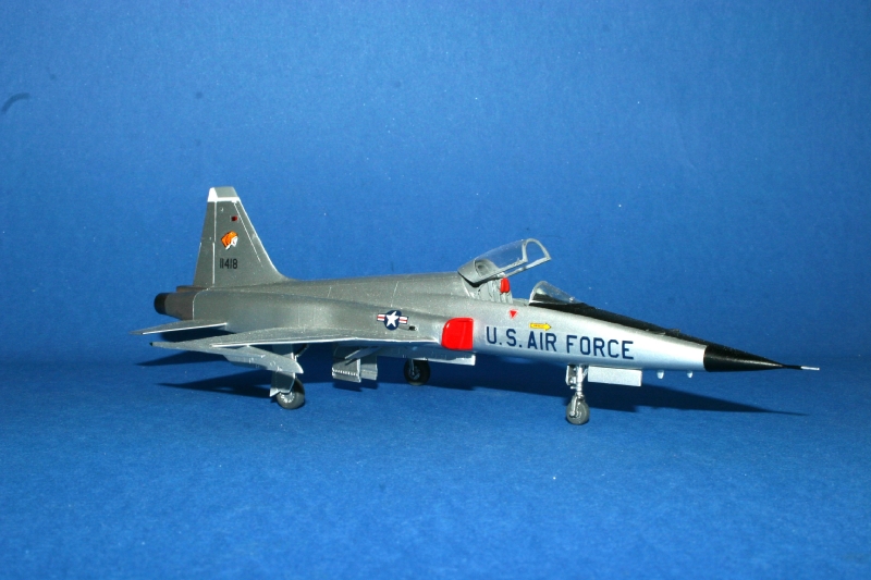

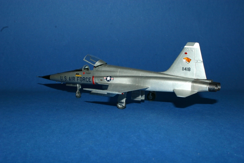

The final aircraft was used for development work by the USAF. I chose to depict it as used during trials of the GPU-5/A gun pod (the pod is not shown in the photographs as I had not painted it at that point!)
