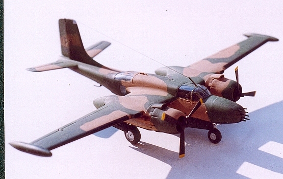

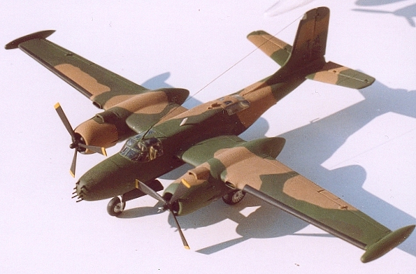

CONSTRUCTION
Construction of this kit is fairly straightforward, so I'll just concentrate on the areas where I diverged from the standard kit instructions.
Cockpit
I removed the lump from the port side cockpit floor and installed 2 spare seats from an Academy B-17 Fortress. Replacement control yokes were made from strut and paper clips, and installed for both pilots. The cockpit was the painted black, with metallic grey floor and dark green seats. Harnesses were made from thinly sliced Tamiya masking tape to contrast the seat colour.
Fuselage
The gunner's compartment was completed with similar interior decor as the cockpit, omitting the sighting periscope. The resulting holes were filled with Humbrol Clearfix.
I don’t know if the seat was still there on the Counter Invader – and am certain that nobody would use it in combat, but mine retains the seat for daytime jollies.
My plan for a larger rudder was to insert a sheet of plasticard between the rudder halves, then cut a slightly extended outline and re-profile the section.
However this composite went AWOL on my model bench, so I fabricated a new rudder using some round section for the hinge-line, and thin plasticard skins. Trimmed to shape, this was installed as the fuselage was assembled, along with the turret blanking plates.
I sanded away the upper turret contours, leaving a constant upper fuselage section from the cockpit to the gunner's compartment. I have to confess that the lower fuselage was not treated similarly, being fairly well concealed. The bomb-bay was assembled closed, and no kit aerials, steps or intakes were installed.
Then the original rudder re-surfaced, too late to be used, why does that always happen?
Wings
I cropped each wingtip just outboard the ailerons, then assembled the wings according to the instructions. I removed the moulded guns, fitted the tanks, and filled the underwing armament mounting holes. To speed up projects a lot of my models are finished clean, the Counter Invader would be no different.
The wingtip fuel tanks which had started my interest in this project were 45mm long and 7mm diameter, with a straight waist section which roughly matched the newly truncated wings. A survey of my completed models shows that finless tanks from an Airfix Hawk or any first generation Harrier kit would be acceptable alternates with my level of references.
Engines and Propellers
The engine blocks were assembled without modification. I paint my radial engines with Aeromaster Tire Black paint.
The cowlings required considerable attention with coarse wet'n'dry to remove the leading edge air intakes and create a round cross section. This exercise had to be repeated with successively finer grades to restore an acceptable surface.
New air intakes were butchered from Airfix Short Stirling intakes. When I was happy with all the components, the engines were assembled.
The real weak point of the entire project would always be the propellers. With hindsight I should have started with these before taking my scalpel to any other part of the kit.
My first plan was to create a set of correctly shaped blades from plasticard, mastered from the DC-6B props, and graft them onto the original hubs. However I soon realised that this was not a practical solution. The result, if I could successfully build a propeller before amputating my fingers, would look like something from an early steamship!
Plan 2 was to share propellers with the DC-6B, and accept the compromise that these two Douglas Aircraft models would never be seen together.
Airframe Assembly
The wings were mated to the fuselage and engines without further modification. At this point I removed all those horrible rivets, and smoothed all the joints. Also, I packed the solid nose with plasticene to achieve an adequate balance, and completed the basic airframe.
Now that the airframe was complete, I realised that the DC-6 propellers were a bit too big, and clashed with the fuselage. It was necessary to trip 2mm from each tip.
Now the DC-6 was being corrupted, and it should really have natural metal coloured props!
In desperation I hatched Plan 3, and sent a parts replacement slip to Heller, requesting 2 DC-6 propellers.
My interest in this project was waning, it was in real danger of being returned to the pending shelf . . . . . . . . . . . . . . . . . . . . . . . . . . . . . . . . . . or consigned to the bin!
A few weeks later the replacement props turned up. Saved again, thanks Heller! The rest would be downhill, but you will hear more about the propellers later.
COLORS & MARKINGS

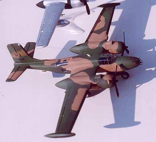

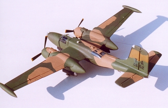

By this stage I'd acquired a copy of Airplane Magazine No 60, with a 3 view colour diagram of the Counter Invader. This and the photos from the book were my painting guides to the theatre standard 3 tone camouflage over black undersides. My model was brush painted with Humbrol numbers 116, 117 and 118, with 33 for the undersides, de-icer boots and propellers. I couldn't work out what the light patch at the top of the fin is, so I just painted it light grey.
National insignia were not applied to Counter Invaders. Markings were restricted to tail codes and aircraft number on the vertical tail. A thorough hunt through my private decal-bank revealed a way of constructing a set of markings for TA 64-662 in black, which neatly fitted into the appropriate range (64-630 to 64-679).
I applied the decals over a wet patch of Johnson's Klear, then pressed them down with a rag. I find that this gives no space for air under the decal, and hence eliminates the risk of silvering. It dries quickly and seals the decal to the model, so no air can creep underneath later. I treated the whole airframe with Humbrol Flat Cote to achieve a consistent flat finish.
FINAL CONSTRUCTION

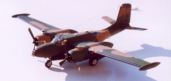

The B-26 has a pronounced 'sit up and beg' posture, which is not reproduced on the model Invaders that I have seen. I decided to replicate this by shortening the main undercarriage legs slightly. I found it very difficult to achieve any strength it the undercarriage again, and resorted to driving red hot paperclips into the legs before the model could stand properly again.
Then I discovered that my cutting was not as equal as I had hoped, and the port leg was shorter than the starboard, to the extent that the propeller almost touches the ground on that side!
Aerials were cut from various thicknesses of plasticard and paperclips, and applied to give the look of a Counter Invader. A nylon thread was anchored with superglue and rigged from the cockpit mast to the tail. Then I run a brush full of acrylic black paint along the nylon for an authentic look.
Final detail of windscreen wipers and navigation lights were added using gel pens. I find I can use these more accurately than a brush for this sort of detail, but they do take a lot longer to dry, so the model has to be handled with care to avoid smudging.
